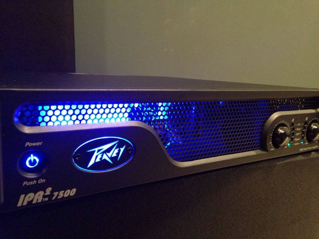

DD - First one has arrived! I powered it up just to check it, but no playtime yet. Stay tuned.
BTW it came with a CD manual which shed some light on some "burst" rating specs, similar to the way the Clone amps are rated. In 2 ohm stereo the rating is 4750 watts per channel @ 1KHZ for 20ms, repetitive. Continuous rating is 3750/ch @ 1KHZ or 3280 full range, 20hz-20khz both channels driven. If they come close these things are going to be monsters. I might have to be careful with two of these beasts powering my Daytons. Applying a low HPF might be a good idea. :D

Haha, with any luck I'll have some listening impressions tonight. I had about 10 minutes last night before our class (newborn on the way) so I got the Crown unhooked and the Peavey hooked up. I ran a quick test tone through it just to check connections, etc. Should be ready to calibrate and/or take some omnimic sweeps. :) Second amp should be here shortly as well.
Update: Got two of these amps in my posession now. I had the chance to hook one of them up last night to 2 of my subs, 4 drivers, in 2 ohm stereo. I run my subs 6-db hot, with Audyssey, and a +3DB LT. Sonically it sounded great - very similar to my Crown XLS5000 which I had just unhooked. Power wise - let me say that one of these amps in 2 ohm mode is too much power for 4 of the Dayton 18s. At about -5 or so with the volume with the Underworld Uzi scene playing the subs easily bottomed. eek.gif Since then I've been very respectful of the capability of this amp. smile.gif I continued playing with 10hz sine waves which had more force than I ever remembered hearing (actually more like feeling) before. Have not seen the clip lights nor will I be able to push it that far in this configuration.
In short - this amp seems to deliver raw, brute, clean power in a stupid light package. One or of these amps and 8 x 8ohm (D4 SIs or so) would seem to be an ideal match. Alternatively in a best case scenario you could run two of these amps, each with 4 8 ohm configured subs for a 4 ohm load per channel. The 18.2's come to mind! I'm going to later try the amp running 4 ohm stereo with all 8 subs running. It's full bandwidth rating is 'only' 2000rms/ch (0.1 THD) or 2450rms/ch (1%THD) but something tells me it will still be more than sufficient.
