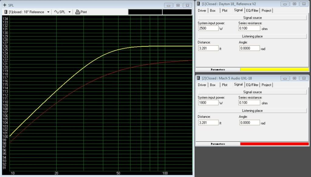

Guys - what are your thoughts on these new drivers from Dayton? The rated xmax is only 12.75mm from the manufacturer, but Josh Ricci's initial testing shows that number to quietly surpass the 20mm mark which puts these immediately in the 'high value' category for the DIY crew.
http://www.parts-express.com/pe/psho...95-472&scqty=4
I had been toying with the idea of building a slew of UXL-18 sealed drivers to experiment with, but now that these are on the market they seem like a more value oriented alternative. They seem to model very well in a dual opposed setup (6-7 cu ft) vs. a single UXL which is actually more expensive.
Some interesting comparisons:
2 Dayton 18's
7 cube dual opposed sealed box
2500 watts
Max excursion ~18mm at 25hz or so
vs.
1 X LMS5400 Ultra
4.5 cube sealed box
2500 watts
Max excursion ~31mm at 15 hz or so
While close at the 10hz region, the Daytons are stronger throughout, with a large advantage in the midrange section.
