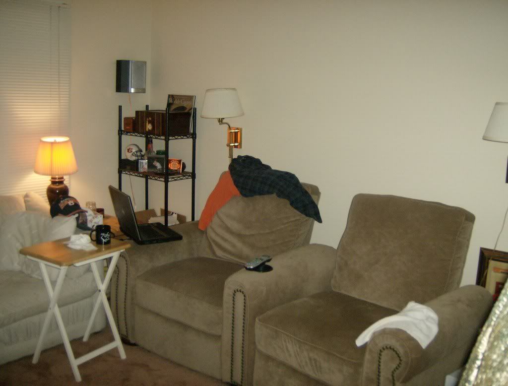

    About to start (finally) treating my room. Going DIY...
    Rear corner traps are gonna be the hardest for me as it is a pretty tight room & I don't want to "invade" it even more. And my wall mount surrounds make it even more difficult to fully treat the corners.
    Which of the above (EDIT: Well, below since I goofed up making a "poll") are likely to be most effective?
    As I have to treat in "steps", which would you start with?
    Pics not great, but will give you an idea of what I'm working with...
    Media & lighting will be moved/replaced...
    EDIT: Arghhh! Was gonna make this a "Poll" and accidentally skipped over "options" - then edit won't let me delete & start over...??? (No delete option???)
    SO: Here are the options -
    1. 2x2x6" Panels Straddling the corner/ceiling intersection
    2. "Smaller" super chunks above & below surround speakers
    3. Panels above, chunks below
    4. Other corner suggestions???
    5. Forget corners for now...just start w/ back wall & re-evaluate
    (I do plan 2, maybe 3, 2x2x4" panels on back wall)
    First, those are not the only corners in the room, dont forget wall to ceiling and wall to floor can be treated as well.
    The advantage of a panel straddling a corner over super chunk is they take less material and are easier to make but only give up a little in effectiveness.
    The superchunk can be more effective and can blend in better. It might be easier to fit in a irregular shape as well.
    Honestly I think all 5 options will work, and since you are going DIY, 5 might be your best bet so you get a feel for the materials before you comit to the difficult part.
