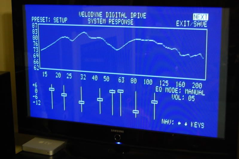

    I built on and it's the best sub I've had to date, dual setups or otherwise. Some of the subs I've had in the past are dual Rythmik 12" (sealed) DIY, dual Infinity Kappa VQ 12" (ported), dual HSU VTF 3.2, dual Preimer Acoustics 12", SVS PB10, etc.
    I already had a little mono-block amp I wasn't using so the entire build was around $275 for me. I don't have any max output graphs but here is an unaltered (bypassing the SMS-1) FR graph of the Tuba in my open room. You should have no problems reaching reference levels of bass with this sub.

            36"wx36"hx24"d It's IMO the best option out there if you want to play with the big boys but don't have a lot of $$. Fad or not, there's no denying it's performance to dollar ratio.
