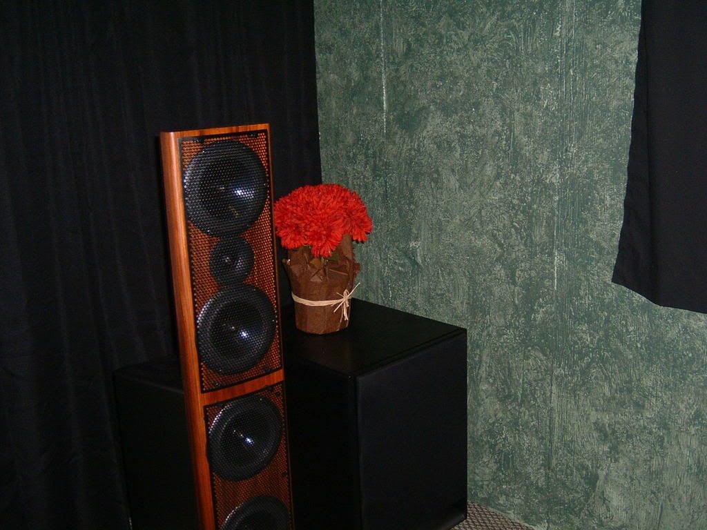

            I two toned my basement wall with 2 paints. I was at home depot one day and an ex college art teacher was working in the paint dept. He said the correct way was to put on a base coat, then mix the second color with a glaze and mix like 4 to 1 glaze to paint. To put it on the wall, he told me there are lots of ways, but a neat random way is to get a target or walmart plastic sack ( whatever kind of plastic sack you can come up with) and just dip it in the glaze mixture and dab, smear, blot, whatever pattern you wish to come up with. The glaze dries clear and leaves the color you want behind.
            It was pretty cool to do and is messy. A sponge roller as mentioned will work great too. I believe you just need to research a bit using glaze to mix with your paint.
            At least this is what I did. Here is a close up of my wall from about 2 feet and another one a little farther away, 6-8 feet or so.
            This was painted onto a white previously painted concrete wall in my basement. My basecoat was the light color and dark color was mixed with the glaze and then I dabbed and smeared it on with a target sack. Oh did i mention it gets messy that way? But sure was fun. I guess you could use latex gloves and take some of the mess away but it washed right off.
