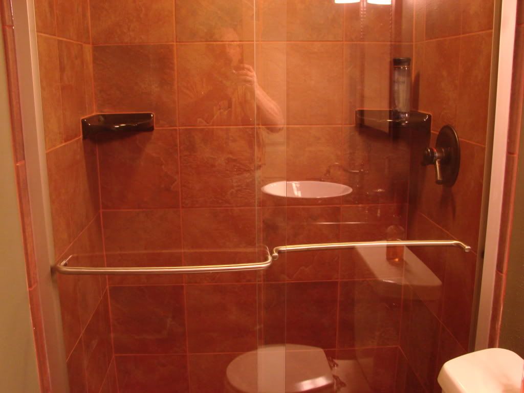

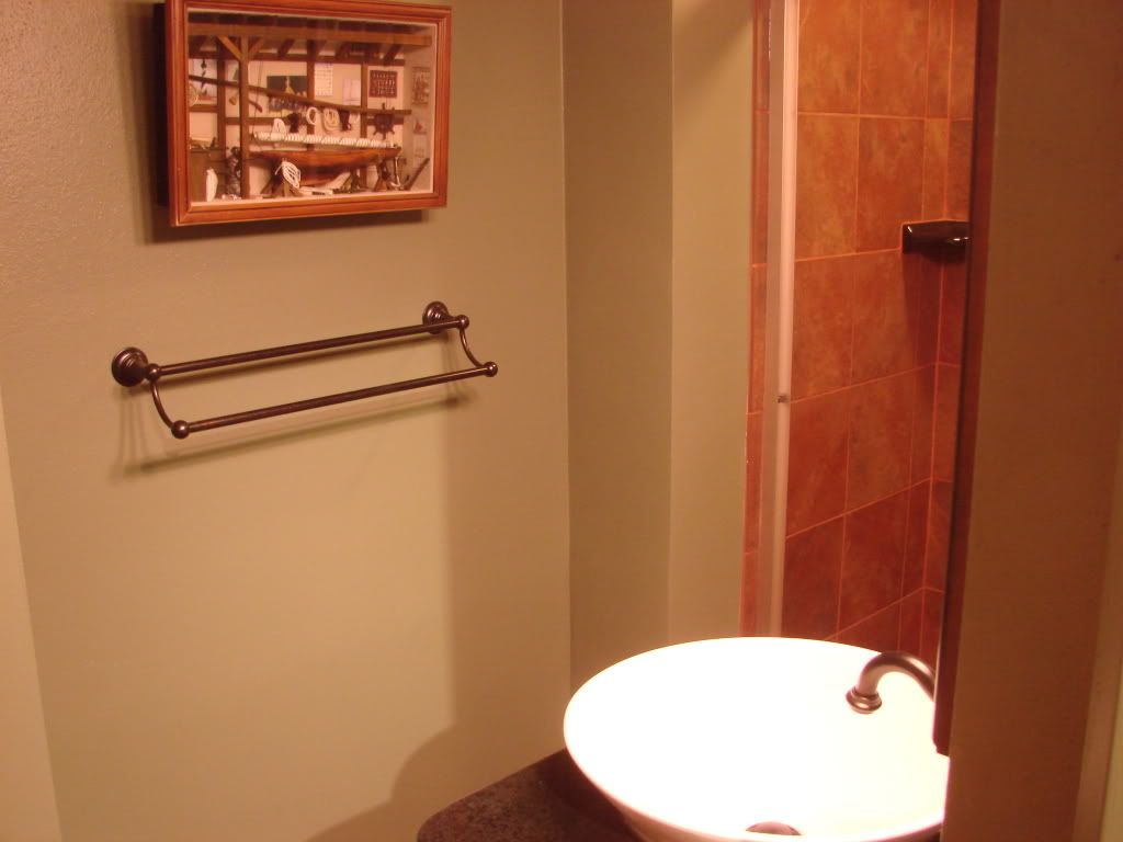

                To give you a point of reference here are some before and after shots. I did mine a couple years ago...it was a complete gut job.
                As you can tell this is a really small bathroom and it cost just a little over $15,000. We did use higher end fixtures though.
                So in this down market and with less expensive fixtures your cost should be considerably less.

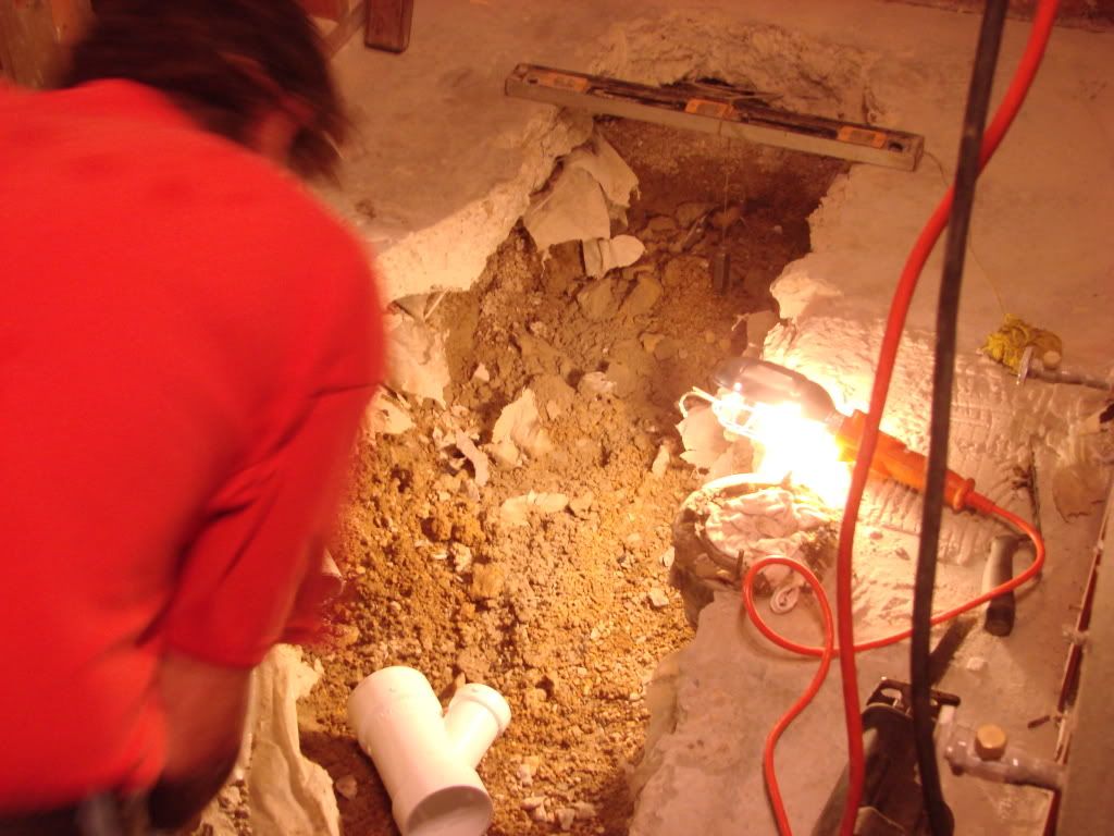

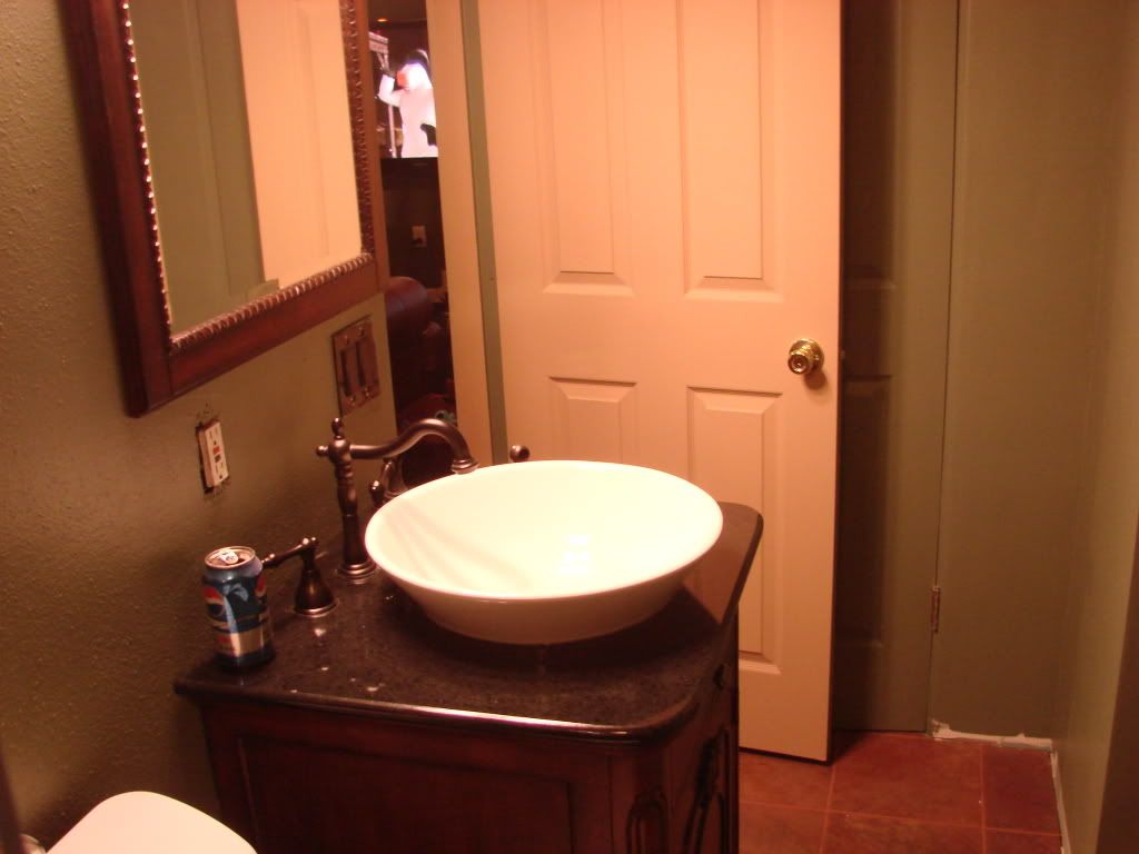

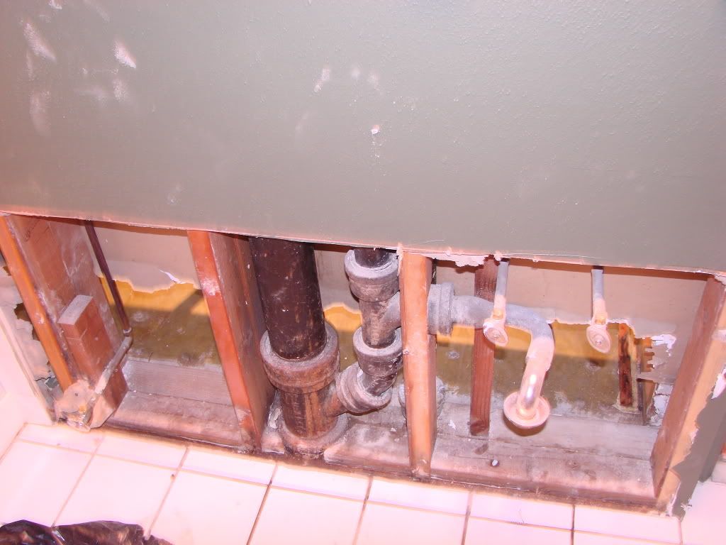

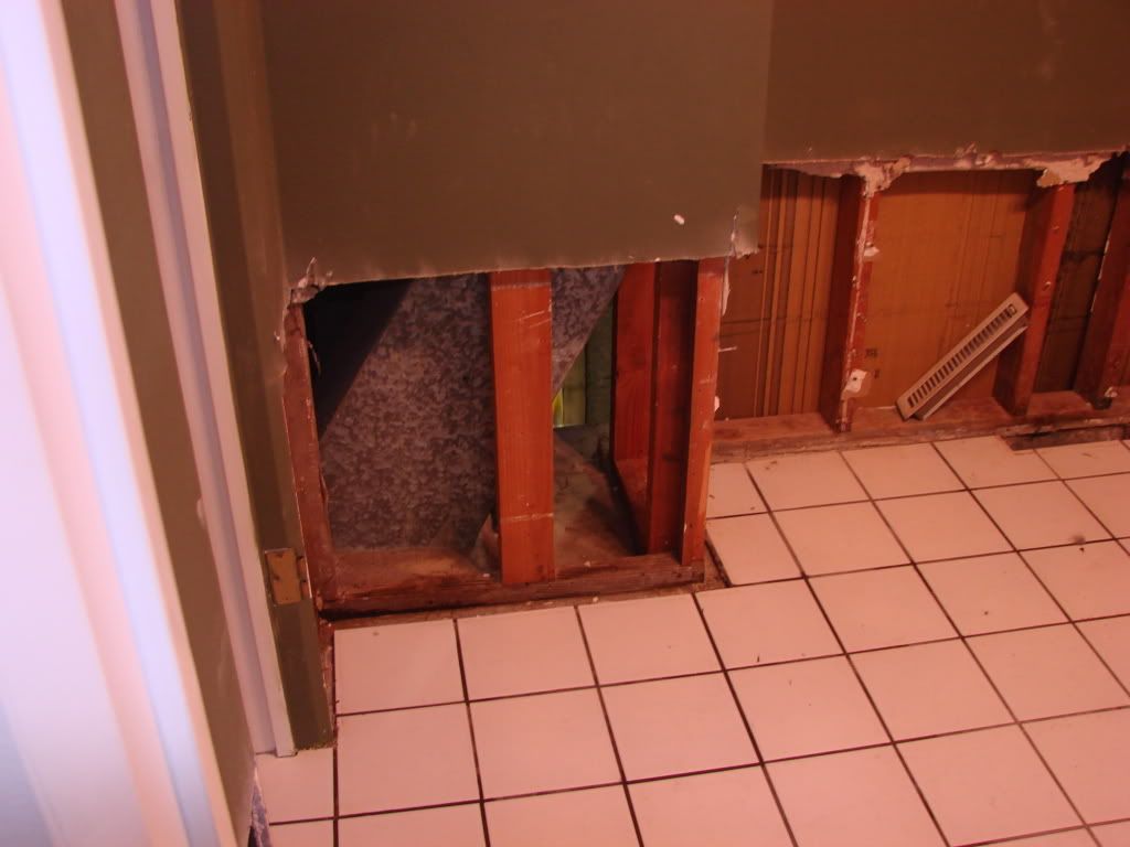

                              In September of 08 Hurricane Ike rolled thru St.Louis with major flooding and massive sewer back ups.. Our Family room bath room was where the sewers erupted..flooding 2 complete levels of our home in a matter of a couple of hours.The walls were cut at 2' off the floor in the beginning on 2 sides of the room,I went ahead and took them completely down along with all the other walls except for the closet area.
                              Any way..we had to completely gut it..bust up the flooring and install new waste lines in the floor and wall for the sink.We replaced the water lines for the toilet and shower with all the cutoff valves and installed a new mixer valve for the shower..We had to replace the shower,vanity,toilet all of the eventually drywall and 1/2 the ceiling along with new doors for both the closet and the shower itself. Originally we had a 3x5x8 full slab marble shower enclosure and ceramic tiles with mid grade accutiments. When we remodeld it..we went with low/high grade tile for the floor and shower..with high end fixtures..The plumbing cost was extremly high on the bids..this was with them jackhammering up the floor and removal of the waste lines.and doing all of the plumbing install of the sink,showerdoor,toilet..What started out as having to bust up what you see here moved out into my family room for another 4' Once the floor was up,we found that the waste line had been split further back than we originally thought.So I had a real time of it with that.The stacks were snapped off and replaced from 2' above the floor and all of the water lines replaced as well.ONce this room was done I finished redoing my audio cabinet right out side of it on the adjoining wall.This wasn't included in the bathroom bid
                              My bathroom floor is 4-6" thick with 1/4" rebar and stell wire in it.. I ended up getting my own jackhammer and doing the grunt work of gutting the entire bath room out including the flooring so the waste/water lines good be replaced.I also painted the room and installed my own mitered base board.I also installed the new glass shower door,toilet,granite topped vanity/sink,and hung the new mirror and light fixtures.
                              If you can manage..do some of the work yourself. Every bit you can do will reduce the cost.For an example..if applicable for you..The clean up from the demo required a 20 foot roll off dumpster..My bids for getting a dumpster and hauling out all of the trash was $1500 $1750-$1900..I got it myself and paid $250 dollars for the dumpster rental. Painting is another way to save..it may only cost a few hundred in your area..but..a few hundred here and there start to add up by the end of the project.
                              My initial $20k remodel job on just this bathroom from the flood was cut by over 1/2.It allowed me to install some really nice fixtures and have a much higher grade tile.You wouldn't think such a small space would cost as much..but..depending on what you put back in and how much labor you can put forth will make a world of difference
