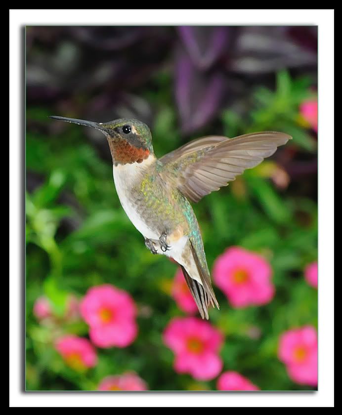

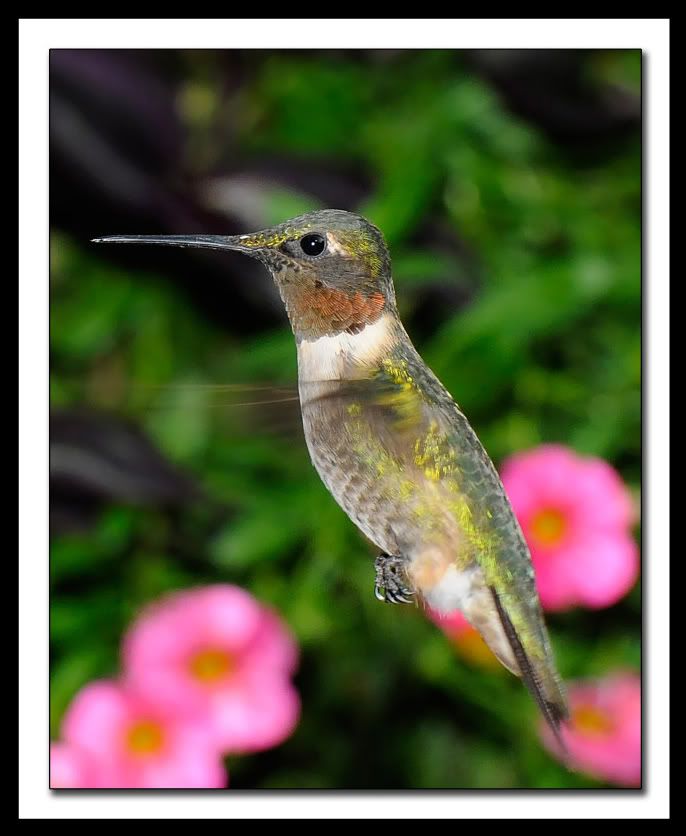

    It is absolute torture trying to shoot these little guys, but I think I have finally figured it out. These turned out OK, but I am going to continue my quest for the perfect shot(s). I find hummers to be fascinating and terribly cute. Hope you like.

        These were shot at f/8. I am going to shoot some at f/11 to get more detail in the feathers. I am also going to shoot some with my macro lens if the little guys will tolerate the intrusion of the lens being so close to them. We shall see.
                  What is your shutter speed? I assume you have some sort of massively bright light behind/beside you to illuminate them so well with a shutter speed fast enough to still-image their wings?

                    Here is how I did it:
                    Shutter speed is important, but not nearly as important as using multiple flashes to "freeze" the little guys. SS was 1/250, 3 flashes set on 1/16 power and flashes were on tripods in a triangle shape around a feeder. More flashes would be even better.
                    I am sitting a lot closer to the feeder this year and that was making it almost impossible to move the camera to focus on the HB's when they came around, so I changed tactics. I prefocused on an area where I thought they would hover then changed to manual focus. I then went back into the covered part of my deck and used my wireless remote shutter release. When the HB's came into the expected FOV, I fired away...on high speed burst.
                    I used my 70-300 VR lens for these shots, but I am not satisfied with the bokeh, so I am going to use my 70-200 pro lens and my 105 macro lens (with a 1.4 TC). Both of those lenses produce wonderful bokeh.
                    If I get any good shots, I will post them.
                        I don't want to undervalue the shots you posted, but I would also be interested in a picture of HOW you take the pictures ... the birdfeeder, the tripods, the flashes, ... I'd be interested to see that..

                          Wallmart has a good feeder...make sure to get a red one. Sugar water...4 to 1 part sugar....cheap tripods...had for years...flashes ain't cheap...I have an SB-800 on the camera and 2 SB-600 on tripods. D300 camera.
                          My setup is like the one shown in the thread.
