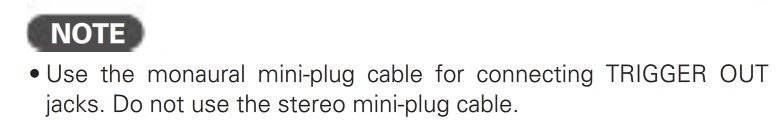

        Steve you very well could be right. I've seen this "stereo" vs. "mono" trigger issue debated at many forums, without resolution, so I'm not certain myself. However, I simply was going by the 4311 Manual which said:
        I failed to notice that this statement seems to imply that both a mono and stereo cable were included with the 4311. So, Bill, you might look through the stuff that came with the receiver to see if you already have the cable(s) you need.
        Of course, the language problems with Denon manuals is well known. It's possible they meant to say "Use a monaural mini-plug" and failed to use the correct word. ;)
