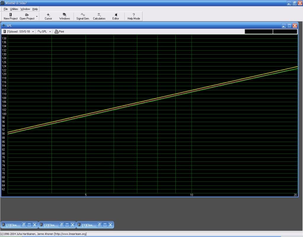

    Guys - I am getting a little weary of the claim about how our subwoofers cannot do deep enough. Here are three subwoofers, all using T/S parameters in Win ISD. All are multi-driver / multi-box units.
    The question is ... Whose subwoofer is represented by each color line? How many of each driver is needed, How much power is needed, and what is the total cost?
    Don't tease us... tell us!!
      Well, I see the project is called VS18 in WinISD, so I'm going to assume that one of those lines represents a pair of VS18s powered by single SA1000 :angel:

            I know what they are, It is going to be my rolloff without room gain once I get the subs mated to my FP10000Q!!
              Gotta guess with 124db at 20Hz, it would take 4 SS18.2s each with a Dayton to get that spl. I'd bet there's 2 LMS 5400s, but with lots more than 1000w pushing those guys. 2000-4000w I'd think apiece. Perfectly follows 12db/octave sealed design, with the properly sized enclosers.

                  I suppose after enough displacement, they all sound the same. So then what do you do next, look at distortion profiles, linearity? Where does it stop? What do you...hear?
                    Just for comparison, I modeled my 8 Acoustic Elegance IB15 drivers with a total of only 400 watts. Drivers and amp cost me $1500 and it will cost about $150 for the manifolds.
                      There is still a question as to whether the Dayton is flat below 20 Hz, or how much off. But, between room gain, placement, calibrated mic and my non-expert ears, this is theoretical territory.

                      Guessing the third driver to be a Mal-X?
                        The SA1000 is 4 dB down at 10 Hz with Bass Boost on, 5 dB down without boost, according to the instruction manual. :yes:
                          Maybe I should get a twin, too? Would sure be more fun!
                          Or the Pi 18"?
                            If you can believe the stated response. I was talking about 3rd party testing, which hasn't been done on this Dayton. I think DD and others have stated there is some hype to manufacturers like the Behringer at least to advertising peak power, and not average power.
