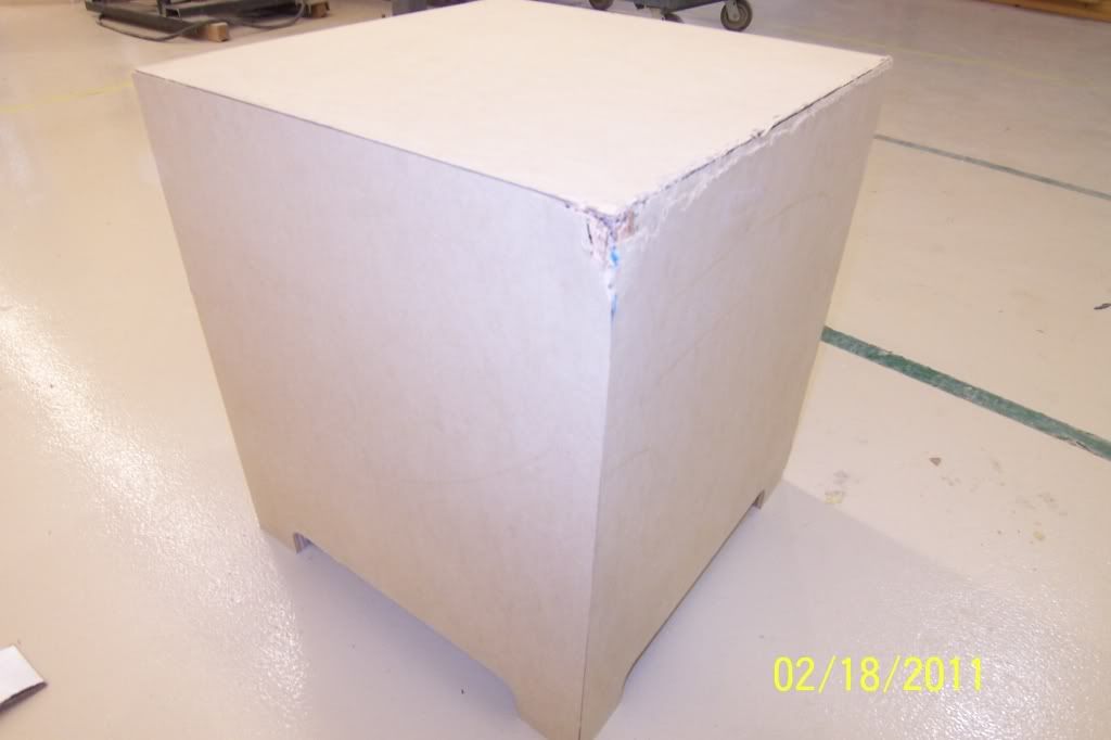

          Did you see the picture of the SS-18.1 cabinet that fell 15 feet onto concrete? I'd say the weight won't be a problem. :applause:
          Consider that from 15 feet the cabinet is traveling at 17 mph when it hits the ground. If we guess that the unfinished cabinet has a mass of 15 kg (33 lbs, this is probably an underestimate) and came to a halt in a distance of 0.02 meters (estimated from damage on corner), it absorbed over 440 joules of energy, which if my envelope-back calculations are correct, is about the same as if it were hit by an average major league hitter, directly with a 33 oz bat at over 66 mph bat speed.
          (I'm sure there's plenty wrong with this comparison, but it's fun to consider.)
