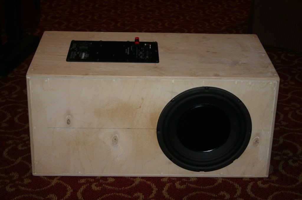

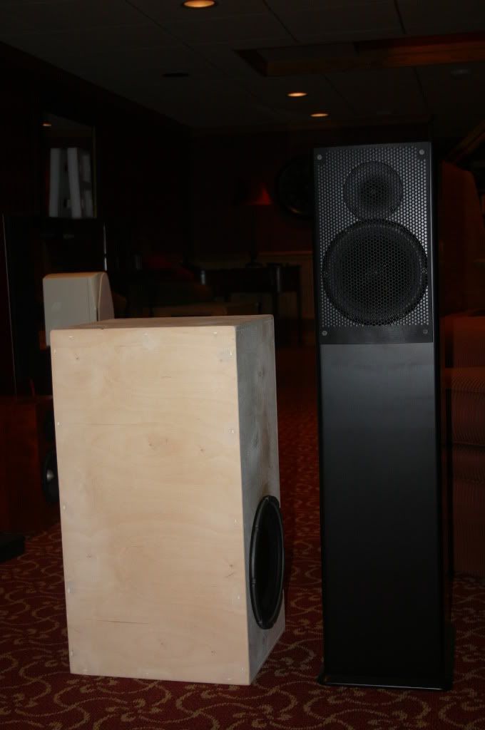

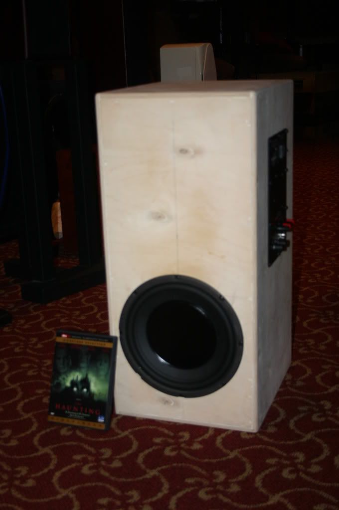

                  Here are the posted specs from the prototypes.
