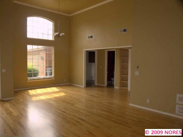

                  Well, things are moving forward on the house. Here's a shot of where I'm putting the 2 channel rig. I don't like the big window there, but hopefully some nice thick curtains will help. I will have diffusors to each side of the widow, and probably traps in the corners.
