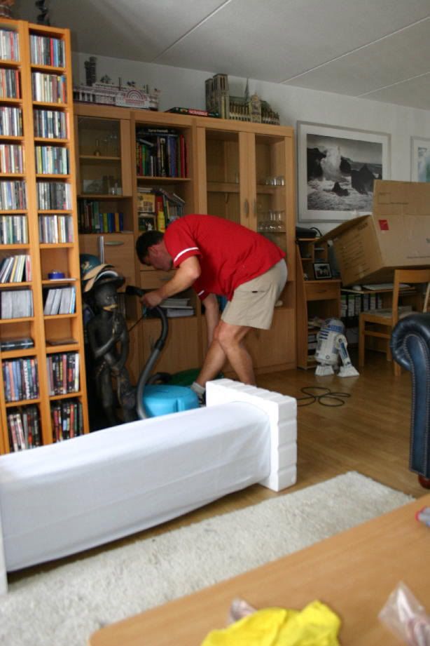

    At last, the first one stands
    Making connections, no problem

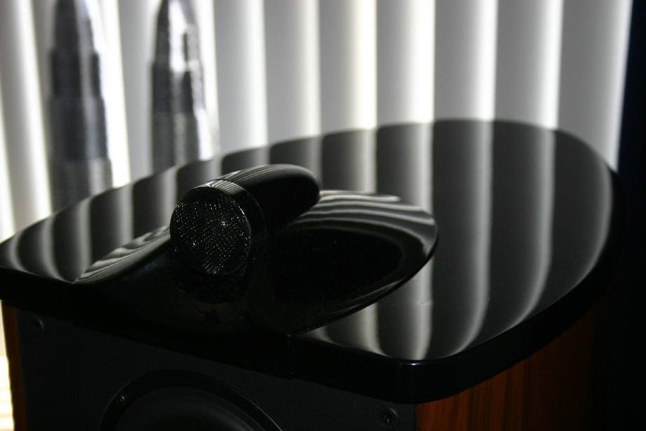

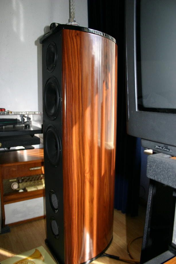

    The appearance of this speaker is gorgeous, beautiful, grotesk, it is a fantastic piece of furniture. And it makes MUSIC. Everybody I know who sees them loves them. Even my sister was impressed, only by the photos.
    I wonder about the dimensions of this speaker. On the Internet it is promised 1330 x 500 x 440. It is in reality: height:1270 width 320 depth 410. Weight is 35kg; I can lift it personally, just under the end cap on the top. Good fitness!

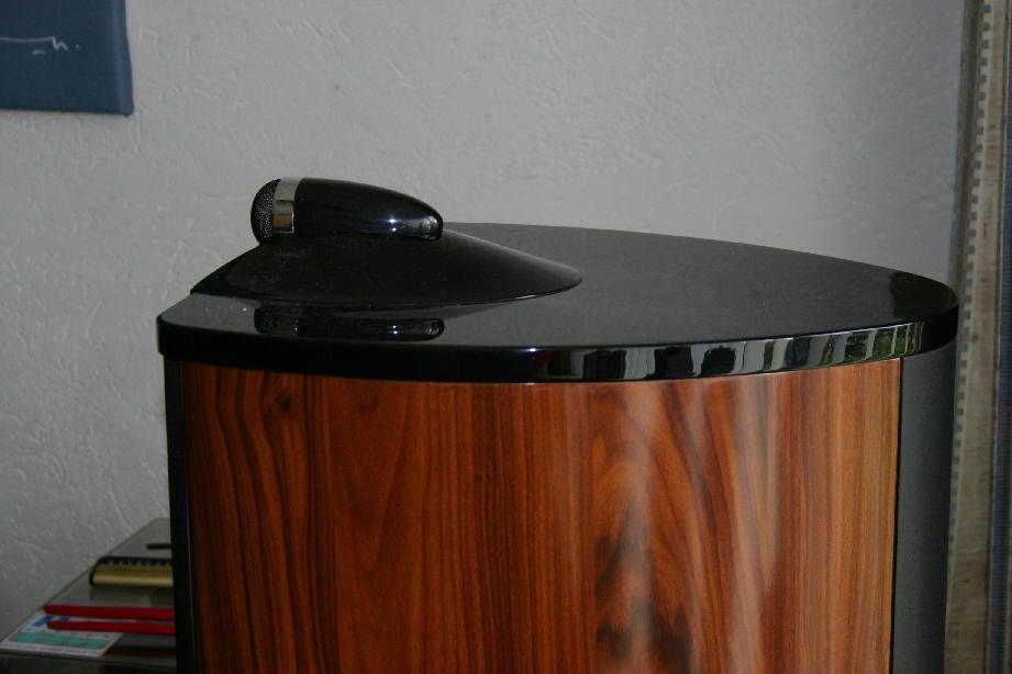

    Lovely end cap

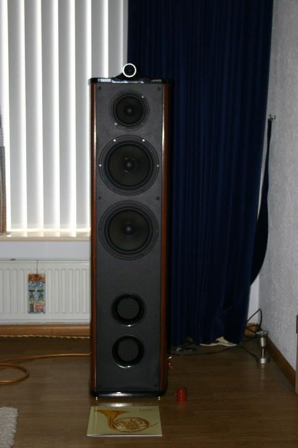

    I would be curious to see a picture (if possible) of the bottoms of your bases where the binding posts are. You say you were able to fit TWO speaker wires into your binding posts?? I wonder if maybe HiVi has already upgraded the binding posts to larger ones since I ordered mine, or if the European versions might be different. There is no way you could fit two wires into my binding posts. In fact a single 12 gauge wire doesn't really quite fit.
    Jon sent me spikes for mine since mine also came with flat, round feet, but I was only able to use them on one of the speakers. The other one was not drilled for the spikes and had only tiny holes big enough for the screws on the feet. The two speakers had completely different feet holes! So I'm waiting on a friend with carpentry talent to come over and drill proper holes for me. I'm not comfortable doing it myself.
    Thanks again. Enjoy!
    Jeff
      Do I see plugs in both of your bass ports? Why, may I ask, did you leave those in there? That would make the speaker sealed instead of ported and would have a dramatic effect on the sound. Have you tried them with one or both of the ports open? My 5.2s did not come with any port plugs. I did try plugging one port on each speaker using a rolled up towel just to see what difference it made, but I did not like the sound. It took away too much bass.

        Dear Jeff,
        Thank you for the compliments, it took about two weeks to complete this report. I do not have a photo of the bottom. But I have a biwire cable that end up in four banana lugs at each cable end. The binding post has in fact two holes: one at the side and one at the end. At the end I can easily plug in one banana lug, as usually is done. The other one can be clamped in the hole that is on the side. Unscrewing the thread is neccessary before you can clamp the lug on the side. Than you must turn down the thread again. With a little fantasy it can be done. If you do not understand, feel free to visit me.

          As far as the famous Swan foam port plugs, they're there to (1) primarily act as a means to seal the cabinet in shipping, and (2) secondarily act as a way to convert the bass reflex tuning to an overdamped acoustic suspension system for those of you absolutely using a subwoofer and electronic highpass crossover to the main speakers.
          A bass reflex system goes much lower but has double the attenuation rate at cutoff. Using the plugs makes it easier to integrate that active subwoofer, provided you remember to highpass those main speakers! Blocking the ports results in substantially higher cone excursion and can damage the woofers. Cross 'em over if you do this to take the bass out of the signal path.
            Dear einsteinjb,
            The photo is taken the day the speakers were installed. I removed the bottom port plug. This creates the best bass response in my room. I have plenty of time to experiment with these plugs. Priority is perfect placement. I use a digital distance measuring device to confirm my ears's listening ability. I was two mm short, comparing left to right distance to the rear wall.

                    Dear einsteinjib and John,
                    About these plugs: I just also removed the bottom plugs from the speaker and in my room this causes too much accent on the drumbeats and lack of tight bass. I also feel that micro dynamics and voices suffer placement and detail. So I put back the bottom plugs and my smile re-appeared on my face. Madonna agrees with me and sings along! I can hardly believe that this will cause damage to the speakers, unless you play on levels that these speakers can achieve. But at that point the police and fire department and the whole neighbourhood will ask you where the concert is! Further more this will cause minor earth tremblings on the Richter Scale. I mostly never listen above 80-85dB.

                      I read my replies and see that I am not clear regarding the plugs. My favourite way is: listening with the bottom plugs IN PLACE AND UPPER PLUGS REMOVED.
                      Sorry for this inconvience, I just discovered my vague description.
                      Look forward to hear from you,
                      Eric
                        Thanks for the clarification Eric. So you do have one port open on each speaker. I think Jon's concern was that sealing both ports might place the drivers in danger of damage because the speakers are meant to be ported, not sealed. As long as you have at least one port open per speaker I'm sure they're fine, and if they sound best to you that way, excellent!
                        (Of course if you feel the 6.2s have too much bass for your tastes and/or your room, you might have been just as happy with the 5.2s... ;)
                        Incidentally, have you done any acoustic treatments in your room? It looks like a very live room with the windows, hardwood floor, etc. I had to treat my room; it's a small bedroom, only 11' x 11'9" (I think that's 3.35 meters x 3.58 meters?), wall to wall carpet but plenty of close, parallel drywall surfaces and right angles, creating that lovely, popular combination of flutter echoes with comb filtering plus too much early reflections. Yech. Room sounds much better now with some simple acoustic panels, and my DIY bass traps/broadband absorbers will be finished soon. :)
