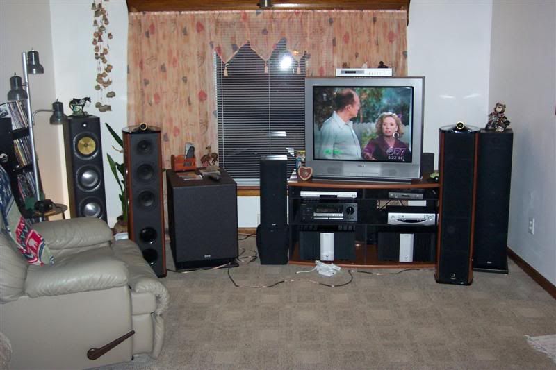

Ongoing impressions: In my family room, Onkyo TX-SR702 receiver vs. Blue Ice power amp
My family room where the Swans now live (till I move them up here to my bedroom in a couple weeks) is 14' x 12.5' x 8' (or 14.5 x 12, I forget), your standard suburban circa 1978 single home family room with drywall, padded wall-to-wall carpeting, your typical comfy sofa & 2 chairs, brick fireplace plus 2 windows on one of the short walls, open doorway plus a half wall opening into the kitchen on one of the long walls, and an opening to the laundry room on the other short wall. Not treated in any way but generally not a bad sounding room; all the openings seem to cut down on flutter echo and comb filtering. I'll post a pic or two if I can figure out how before I fall asleep for the night.
The electronics live in a biggish (for this room anyway) wooden entertainment center on the short wall with the doorway and the opening, flanked closely by the Swans 5.2, which are located approx. 6-7 feet apart on either side of the entertainment center, toed in slightly (front baffles are usually 2-3 inches out in front of the entertainment center.) For critical listening I like to move the Swans about 6 inches out from the entertainment center and several inches forward into the room to improve imaging and lessen the baffle effect from the entertainment center and TV (just your basic old fashioned 27" CRT). It seems to help a bit and pulls the imaging together just enough to notice. I really don't have much room to play here with placement.
Equipment list:
Receiver: Onkyo TX-SR702 (100 watts/channel x 7 but my system is 5.1)
DVD Player: Toshiba SD-4900 Progressive Scan with DVD-A capability, connected to Onkyo via coaxial digital cable.
Speaker wire: SoundKing 12 AWG oxygen free copper zip cord (from Parts Express)
Center: Currently awaiting the new Swan 5.2C, so in the meantime I'm using a single Ascend Acoustics CBM-170SE, located on top leading edge of entertainment center angled down slightly towards listening position. Normally I use the CBM-170SEs as studio monitors in my little mixing room, paired with a Hsu VTF-2 Mk2 sub. Outstanding bookshelf speakers!!!! Due to their accuracy they make great studio monitors. Obviously they don't have the big sound or bass response of the Swans (they're not designed to) and they're less forgiving of poorly recorded source material than the Swans, but with good material they're wonderful. One of them sounds great as a center channel while I wait for my 5.2C.
Surrounds: SVS SBS01 on 31" Sanus Systems BF-31B Wood Speaker Stands. I really like these little guys. Slightly low sensitivity at 85 dB so I need to bring them up a few dB in the Onkyo's setup, plus they aren't quite in the same league as the Ascends, but they're definitely cool little surrounds.
Sub: SVS PB10-ISD
I knew bringing the Swans home to my Onkyo TX-SR702 receiver (rated at 100 watts/channel @ 8 Ohms x 7) would be a bit of a disappointment after hearing them on the Rotel amp, and it was. The Onkyo's a decent receiver and sounds good with the Swans, and in fact the Swans sound AMAZING at low volumes (they lose NO clarity, everything is crystal clear and defined including the bottom end, imaging is excellent, etc.), but when I turn it up close to the Onkyo's limits (not even close to distortion, just approaching "loud") I feel the imaging starts falling apart a little and I can start hearing "speakers" rather than just MUSIC. They lose some of their transparency. This did not happen on the Rotel gear in Mike's room, which is considerably bigger than mine and harder to fill. It's not an obvious thing and I would bet most regular folks could never tell the difference, but I would think most non-wealthy music lovers who care enough about audio to drop $1K on a pair of towers would probably hear it.
These effects are a pretty clear symptom of underpowered speakers and pushing your amp a bit too hard. The 5.2s are a 6 Ohm speaker rated at 90 dB sensitivity, not a difficult load but assuming it dips lower at certain frequencies I suspect the Onkyo is just running out of headroom and having a bit of a hard time handling the load at higher volumes. My little SVS and Ascend bookshelf speakers sound outstanding on the Onkyo as did my B&W DM602 S2s, but I'm sure any full-range 3-way 4-driver tower will present more of a challenge.
Now I simply can't afford a Rotel so based on a bunch of reading (mostly on AVSForum.com) I ordered a Technical Pro (or Technical HiFi, they can't seem to settle on a name) Z-5000 Blue Ice 2-channel power amp. 350 watts/channel at 8 Ohms, stable down to 2 Ohms, can't find a bad word about this amp anywhere. I use Crown (Macrotech) and QSC (PLX and Powerlight) amps in my job every week and LOVE them both, and would have chosen a smaller amp from one of these two companies (probably the Crown XLS-402), but with the good reviews on the Blue Ice plus the RCA unbalanced inputs, low price and reportedly quiet fans (they are, almost silent), I took a chance on the Blue Ice. I posted a detailed review of it on avsforum.com a few weeks ago.
As usual I tried it at Mike's first on his new Dalis, and basically we agreed that it's POWERFUL (actually louder than the Rotel at any given pre-out volume), but slightly brighter and somewhat unrefined compared to the clean sweet sound of the Rotel. It did NOT have the powerful bass response that the Rotel has. Not at all unsurprising; the Rotel has a rep for smooth, warm, lush sound, whereas the Blue Ice is a cheap pro amp designed for DJs. The Dalis sounded great with the Blue Ice but when we hooked the Rotel back up, we were both like oh yeah, THAT's why we love these speakers so much.
Interestingly, after this I didn't have high hopes that I'd love this amp with the Swans -- but I do! It has WAY more than enough power and headroom, so they no longer sound choked. They're transparent, imaging fully intact, and magical. Less refined and sweet, a touch rougher than they should be, but it's a big improvement overall from the receiver. And the bass is outstanding with this amp! Absolutely no boominess at all, just clean, unlimited punch and power. Makes me drool, wondering how the 5.2s will sound in a good treated room with a real quality amp. I've been researching acoustic treatments like a fiend lately and the consensus seems to be that average equipment in a properly treated room can sound better than world class gear in a bad or untreated room. The Swans 5.2 are IMO way better than average speakers, especially at their price point, so paired with a decent amp, good source components, and a good room, wow. In the next few weeks I'm combining all my HT gear plus my recording and mixing gear in my 11' x 11'9" x 7'6" bedroom (the Swans plus 2 subs will be stupid in there!) with some DIY acoustic treatments. I'll post updated impressions after I get this all set up.
By the way, I've watched several movies using the Swans now including Doom, Chicken Little and a couple of other Pixar movies, Master and Commander, The Legend of Zorro and others, first with a BIC Venturi DV62CLR-S center speaker with Ed Frias' xover mods and more recently using the Ascend CBM-170SE as a center, and I have to say, even with the Onkyo powering them (there's no room to keep the Blue Ice hooked up in my entertainment center; it'll get hooked up permanently upstairs) their HT performance is outstanding. The B&W DM602 S2s I used to have had a nice big sound for HT but lacked the smooth beauty that both the Swans and the Ascends have; the Ascends sounded sweet and clean but lacked the big sound needed for sweeping epic soundtracks like Lord of the Rings. I'm pleased to say that the Swans 5.2 give me the best of both worlds and more for HT performance and I couldn't be happier with them. And I can't WAIT to get my 5.2C!!
