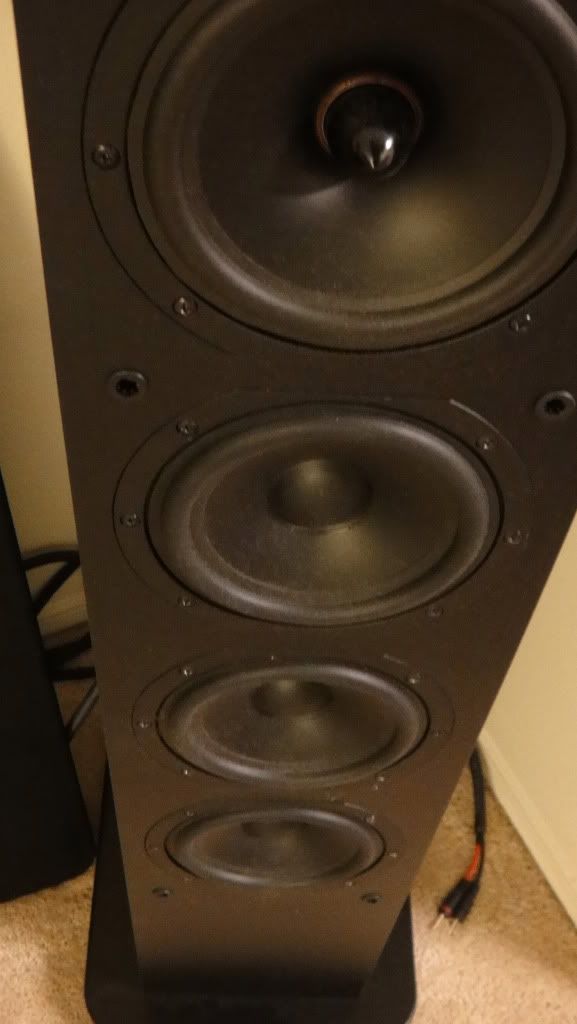

    I know I'm a HUGE tease for only posting a few pictures, but here it is:
    Jon has in my hands a prototype pair of ARX A5 tower speakers. Brief specs:
    • 3 XBL2/splitgap motor 5.25" midwoofers.
    • 1 dedicated midrange with non-moving phase plug and multiple copper shorting rings.
    • 1 ARX tweeter.
    • 1 ingenious crossover network that Jon has been fine tuning (by ear) since late 2010.
    • Tunable ARX cabinet bass reflex port (tweeter and mid are in separate sub-enclosure).
    • 6-ohm nominal load (very benign and EASY to drive....NO 3-ohm dips or other anomalies).
    • Crossover designed from the outset with high current bi-amplification in mind.
    They sound massive. The A5's sound ten feet tall and the soundstage is so wide that my wife has been repeatedly startled when watching movies in stereo direct by sounds she thought were coming from BEHIND her. Articulate and dynamic bass down to the low 40hz range in my 22x24ft listening space. They integrate perfectly with my eD A7s-450.
    They've been driven so far by an ultra-cheap Yamaha surround receiver from ~2005 (read: bottom of the line from b*st buy) and by my Arcam AVR300 using 12awg pre-terminated speaker cable. While they respond superbly to high current amplification (like the toroidal power supply in my 120wpc X2 [in stereo] Arcam AVR300), they also sound darn impressive on low-current budget receivers and amplifiers.
    Most importantly, they are MUSICAL. Music just comes to life on the A5's! The Rolling Stones 'Shine A Light' on Blu-Ray is simply stunning.
    They are due in fall of 2011 (not long!)...I can verify that there isn't a tower speaker anywhere NEAR these in price/performance......
    More to come.....;)

          The mid works so smoothly with the tweeter, that I never put the grills on. There's no fatigue...just tons of clarity. You can probably see all the dust on the drivers in the pix above, now you know why. ;)

                      The ARX midwoofers are kindof a misnomer. They are done a GREAT deal of injustice by being called a midwoofer. They are every bit of a woofer. Enormous XBL2/Splitgap magnet structure, plenty of excursion clearance, cast metal basket (for strength and effective heat removal from the motor), vented pole piece, long tinsel leads, etc. They move substantial amounts of air.
                      However, the ARX midwoofer is done an equal injustice by being called a midwoofer. It is every bit an excellent midrange, with extremely low distortion (roughly 30% less than other motor designs), copper shorting ring, even dispersion, high cone breakup frequency, and an even response deep into the low 'tweeter' territory (flat extension far above their ~2.25kHz crossover frequency).
                      SO, we're left with a compromise in name only. :)
                      Last pic is of the ARX midwoofer resting on the floor next to a standard size DVD jewel case, for size reference.
                      With the short XBL2/Splitgap voice coil & former, excursion is generous. X-max (excursion within the MUCH-reduced distortion limits) of an estimated 9-10mm...one-way.
                      As per the usual XBL2/Splitgap design, max clean excursion is typically twice the thickness of the top plate. I measured the top plate to be just over 11mm in thickness. So a conservative estimate of clean two-way excursion is ~18mm. There is even more raw mechanical clearance in addition to that.
                      Without sounding cocky, I am fairly confident that you will not find another midwoofer/driver using this level of quality and technology in the ARX A1/2/3/5's price range. And we haven't even gotten to the planar tweeter yet...
