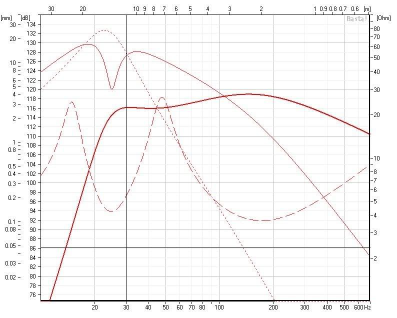

                            How does this strike you? Basic parameters are $1,000 ID-only, 1,000watts, triple 12" drivers, passive-radiatored, and under 24" square.
